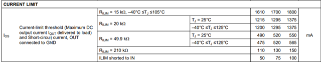

Hi team,
Could you pls help to check what the current limit is if Rlim is open/floating? Can the device work normally? Customer is evaluating shrinking PCB size and unnecessary outer components. Thank you!
  • Hi Xizi,
    Performance is not guaranteed with RILIM set as open.  The current limit should be <100mA but cannot be guaranteed.
    Instead, the customer can short ILIM to IN.  This will set a 75mA typical current limit.  From the datasheet:
    "While the maximum recommended value of RILIM is 232 kΩ, there is one additional configuration that allows for a lower current-limit threshold. The ILIM pin may be connected directly to IN to provide a 75 mA (typical) current-limit threshold. Additional low-ESR ceramic capacitance may be necessary from IN to GND in this configuration to prevent unwanted noise from coupling into the sensitive ILIM circuitry."
