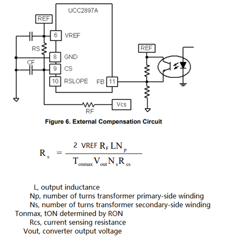

This question is about the external slope compensation circuit for the UCC2897A.
Our customer is considering an external slope compensation circuit, referring to the document at the following URL:
External Slope Compensation for UCC2897A in Some Special Applications
https://www.ti.com/jp/lit/an/slua548/slua548.pdf

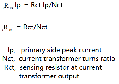

They want to determine the RS resistor value in Figure 6. External Compensation Circuit in this document, but the document does not include instructions on how to design the RS resistor.
Please let us know the formula for determining the RS resistor.
