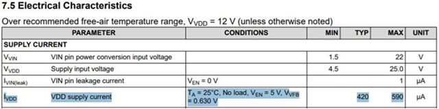

The following IVDD value specified in the datasheet is at FCCM mode or at AutoSkip mode?
How much differences between at FCCM mode and at AutoSkip mode?

Hi
data sheet test condition only mentions VDD voltage which implies not switching , just applying voltage on the VDD so there is no question of fccm or skip mode
but pls check the typical Ivdd current in FCCM and Skip mode on EVM for your application case
