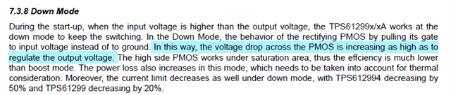

I have a question about this sentence in 7.3.8 Down Mode:
「In this way, the voltage drop across the PMOS is increasing as high as to regulate the output voltage.」
I assume that the increased voltage drop across the PMOS-FET will temporarily decrease VOUT.
So does that mean there's a need for boosting?
