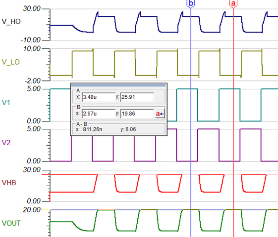

    I was able to download the transient model test-bench but unable to get it to work. I have modified it to configure as a half-bridge driver driving 2 NMOS 2n6755 transistors. A diode 1N1200 is connected across VDD and HB & a cap of 10n across HB and HS. VDD=5V and the high voltage HV connecting to the drain of upper NMOS is 20V. I have applied complementary 5V amplitude 1 MHz square wave inputs to HI and LI. The output is stuck at 9.2 V. So is VHO. VLO is almost ground.

  • Yes, that was the issue. However, I am still not getting the proper levels at the output. With VDD=10V, HI and LI still at 5V amplitude I am getting 29.7 high level and 9.9V low level at the output whereas my high voltage battery is at 20V. A VDD of 9V is OK altho' I would prefer a 5V VDD (same as my input levels).
    I also noticed that the Spice Level-3 models of all the MOSFETs in the library are the same. Not sure if I am using the right MOSFET model.

    Can you provide a picture of the schematic that you are simulating, I am curious if the HS pin is switching to ground to charge the HB-HS capacitor in your simulation circuit. Also in your sim results can you confirm the HB-HS differential voltage and the HO-HS differential voltage when HI is high.
  • The schematic is attached. The circuit seems to work with a proper NMOS transistor model. I changed the model to Spice-Level-1 with parameters Vt=1V, kp=2m, gamma=0.5, phi=0.6. The output is switching from 0 to 20V as expected and the bootstrap cap seems to be getting charged as expected.
