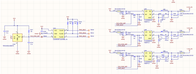

When LM3880MF-1AANOPB is used in below circuit, there is something wrong and doesn't work normally.
Could you help to check the schematic! is there any missing?
Sequence Device: LM3880MF-1AANOPB
Buck: TLV62569DBVR x3
Failure waveform. Power sequence function doesn't work normally.
  • Hi
    The circuit seems ok. I would suggest to check the VCC(5V) and EN pin during the power up.
    The EN shall below ON threshold until VCC reaches 5V.
    I also suggest to probe FLAG1/2/3 when the problem occured.
