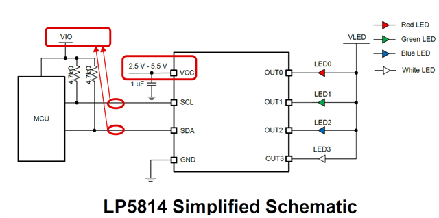

1. Hardware check
  • Measure the voltage on the VCC pin of LP5814 / LP5815 / LP5816 / LP5817, make sure the voltage is between 2.5V to 5.5V
  • Measure the voltage on SCL / SDA, make sure the SCL / SDA stay in High state as the voltage of VIO while there is not I2C communication. Please note that pull-up resistors are required for SCL / SDA.

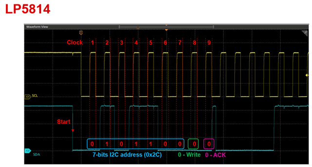

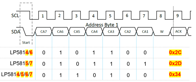

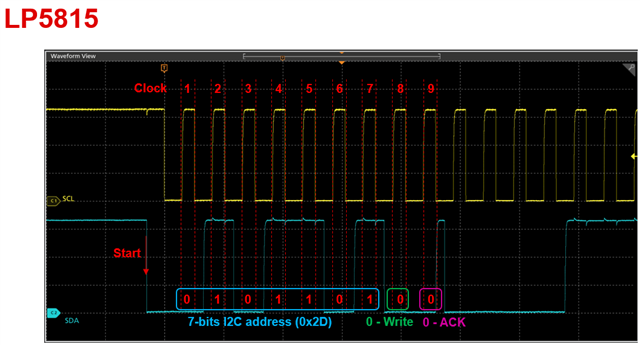

2. Device I2C slave address check
  • LP5814 and LP5816 have the same 7-bits independent slave address 0x2C
  • LP5815 and LP5817 have the same 7-bits independent slave address 0x2D
  • LP5814 / LP5815 / LP5816 / LP5817 have the same 7-bits broadcast slave address 0x34
3. Real output I2C data bits check
  • Usually we may see the correct I2C address has been set in the code, but still meet the NACK. Then we may need to doubt the actual output bits on the SCL/SDA are not mapping the code data
  • Use the oscilloscope or digital analyzer to capture the bits on the SCL/SDA
  • Compare the captured bits with the code data
