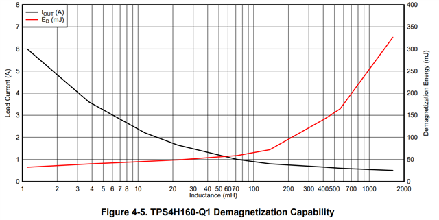

Please provide the Demagnetization Capability for TPS272C45 same as TPS4H160-Q1 on Page 34 (Figure 4-5).
Link : www.ti.com/.../slvae30e.pdf

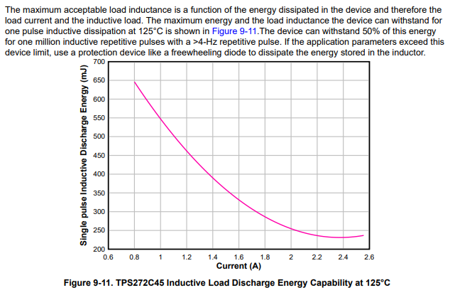

Hey,
The datasheet shares the discharge capability for TPS272C45 in section 9.3.3.2.
BR,
Alan
Hello Alan,
I want Demagnetization Capability curve for TPS272C45 same as below curve for TPS4H160-Q1.
A curve like what is in the application note is not readily available for the TPS272C45. What is provided in the datasheet should cover all needed details for inductive load demagnetization. What are the gaps with the current graph?
