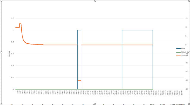

Hoping you can help debug an issue with our battery design utilizing the BQ40Z80.   QMAX does not appear to be updating during normal cycling (with long, multi-hour rests - Rest bit is setting).

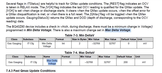

Additional can you please provide insight into Min Delta Voltage and Max Delta voltage and how they are used to gate QMAX updates?    Is Max Delta Voltage a maximum allowable cell to cell delta for a QMAX update to occur, or something else?
I can provide logs and parameters - please advise.
Thank you
