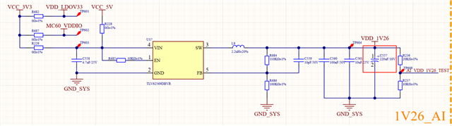

Hello:
Could you please take a look at this component, TLV62569DBVR? If the output terminal is connected to a 220uf capacitor, will there be any risk? Thanks!!!
  • Hi Jimmy,
    Thanks for your query. Yes, having high output capacitance of 220uF might affect the stability of the device as it is out of specifications mentioned in datasheet. For this Vout setting, having a nominal capacitance of 22uF would be enough. Let me know if there is any confusion or any additional concern.
