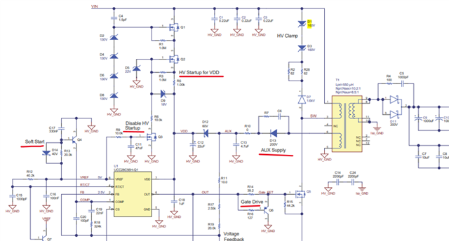

I have two requirements for a power supply design and would like your guidance:
  1. 72–120 V → 12 V, 2 W converter (Flyback or any easily isolated converter topology).
  2. 400–800 V → 12 V, 2–5 W converter.
I would like to clarify the following points:
A. Can I use this flyback control IC for both designs? If not, could you please suggest suitable alternatives?
B. If I want to commonize both designs on a single PCB, is it possible by changing only the transformer (turns ratio), or are there other major changes I should take into account?
C. I need to understand the high-voltage startup for VDD. Specifically:
  • Why are two N-MOSFETs used and how are they controlled?
  • How is the controller’s VDD voltage maintained during operation — is it always supplied from the auxiliary winding or can it be sustained from VIN?
D. Could you also explain the role of the leading-edge blanking (LEB) circuit used in this schematic?
Thank You!
  • Hi Yakshraj,
    Thanks for reaching out.
    Yes.
    As mentioned in the datasheet, table 9-1 (page 27/54), the converter can be designed for a wide Vin range. So, the same circuit should work for your application.
    The HV Startup circuit utilizes two 600-V depletion mode MOSFETs (Q1, Q2). The depletion mode MOSFET conducts when no gate voltage is applied and begins to turn off as the VGS voltage becomes more and more negative. It is completely off when VGS is below the turn-off threshold. The characteristics of the depletion mode FET make it well suited to implementing a current source for high-voltage startup. It is difficult to find a low-cost and small-size depletion MOSFET with 1.2-kV rating, but there are wide variety of selection in 600-V to 800-V domain. Therefore, the stacked depletion MOSFET configuration with the proposed gate clamp circuit will evenly distribute the voltage stress from the 1-kV input voltage.
    During high-voltage (HV) startup from VIN, capacitor C12 must hold the VDD voltage above the UVLO turn-off threshold until the AUX voltage rises high enough to forward bias D12. If the value of C12 is not high enough the VDD voltage will decay below the UVLO turn-off threshold and the converter will prematurely stop switching. The controller will continuously cycle on-and-off as the VDD voltage transitions between UVLO turn-on and UVLO turn-off. One of the most common issues seen with new designs is the VDD capacitor value is too low and “there's no output voltage” or "it's not starting" is reported. The electrolytic bulk capacitor (C12) should be located relatively close to the VDD pin. On the other hand, the high-frequency bypass capacitor, C18, must be a ceramic type and be physically placed and grounded as close as possible to the VDD pin. A 1.0 μF, X7R capacitor is recommended for the high-frequency decoupling. To offset the effects of DC-bias, this capacitor must be rated to about 2x the expected VDD voltage (≥35V)
    Please feel free to refer to the doc below:
    https://www.ti.com/lit/pdf/sluaal3
    The role of LEB circuit is just to add additional delay to the CS pin like a deglitch time to make sure that short transients on the CS are not triggering and over current event shutting down the PWM controller. Hence, this additional circuit (RC time constant) acts like a deglitch filter to that pin.
    Hope this helps. Please click on the green button if this resolves the issue, if not feel free to ask more.
    Pratik A.

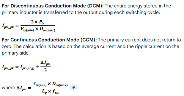

  • Thank you for your guidance so far. I have a query regarding transformer design for a flyback converter using same Controller IC.
    • How to correctly size and calculate the transformer parameters when an auxiliary winding is used for PSR.
    • Whether any reference Mathcad calculation files or design worksheets for transformer design and Flyback converter design specific to this IC.

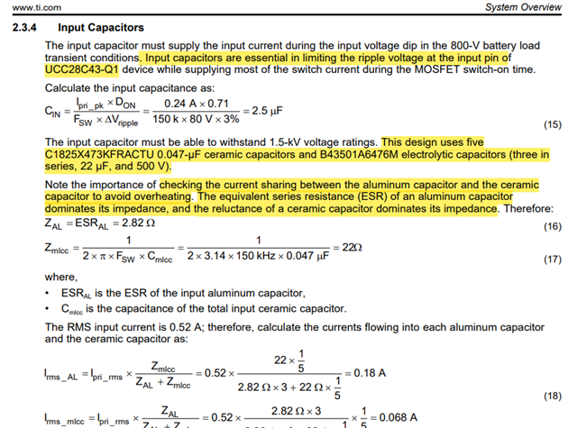

    • I’ve take help from the attached reference document but I’m unable to understand why the calculation uses Vin = 80 V, Ipri_pk=0.24A  and Don = 0.71 mean?(given the duty cycle range of 0.15–0.85).
    • Also, please confirm Cin = 2.5uF how?

  • Hi Pratik,
    Thanks again for explaining, and The third point is my major concern.
       I’ve reviewed the attached reference document but I’m unable to understand why the calculation Value are: Vin = 80 V, Ipri_pk=0.24A  and Don = 0.71 mean? (given the duty cycle range of 0.15–0.85).
    Thanks!
  • Hi Yakshraj,
    Understand. My calculated value is the same as yours, please consider it a typo.
    Pratik A.
