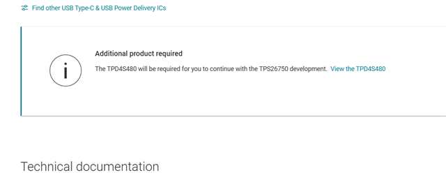

If we did not use EPR, do we still need TPD4S480?

What is the difference between TPS25751 and TPS26750? The main consideration is EPR function?
Do you mean TPD device has to be applied? Datasheet shows that it can be replaced with TVS if EPR is not used.
Yes.
Can you provide a reference from the datasheet? This would need to be corrected.
