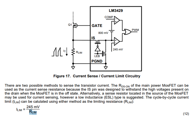

Hello, I am using the LM3429 to design an LED driver circuit, but I encountered an issue where the LM3429 is not working. I am using a buck circuit with an input voltage of 51V, a current design of 50A, and a switching frequency of 700KHZ. There is no output voltage, and the VCC pin of the IC measures only a few hundred mv. Is there a maximum current or power limit for the LM3429? The attached image is my schematic. Can you help me? Thank you.

    I see you have two 2mΩ sense resistors in parallel for a total resistance of 1mΩ. According to the datasheet equations, the 1mΩ sense resistors corresponds to 100A, not 50A.
    You also have an effective 1mΩ limiting resistance which corresponds to a current limit of 245A. This could be a serious problem.
    Even if you fix these errors, as this device was designed for ~5A applications, I am doubtful that this design will function effectively at 50A operation.
