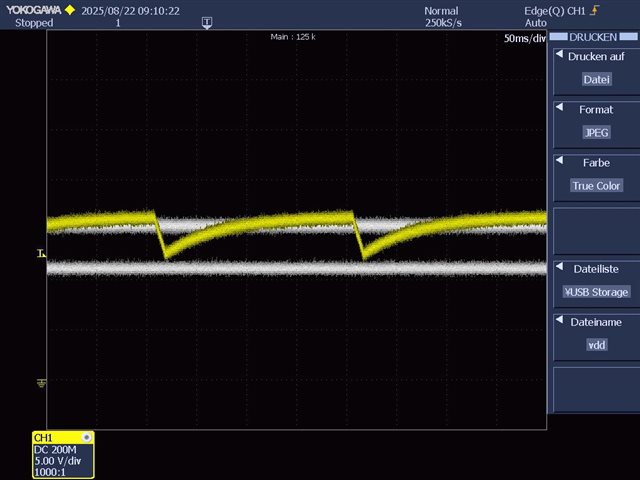

  • Hi Hong,
    The clamping voltage of D5 is 22V. The yellow waveform is of Vdd pin.
    Both white and yellow are VDD based on your message -  but they are not the same. Please explain.
    UCC28C59-Q1 needs 17.2V to start. It looks VDD on UVLO on and off.

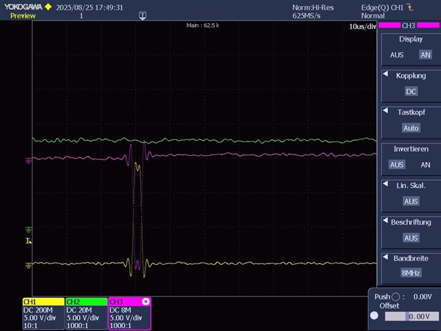

  • Hi Hong,
    Yes all the waveforms were from Vdd pin. I just saved the behavior under different VIN (24V, 32V and 34V). When i increased VIN, VDD voltage improved but ultimately started showing sawtooth which is shown in yellow.
    On your second suggestion, i removed the R1 and R4 and gave 18V on the VIN. I see that the VDD pin rises to 18V but i couldn't see any output pulses. But when i turn off the VIN, the IC outputs two 5usec pulses randomly approx of 13V amplitude as shown below. then i also see small voltage across the auxiliary winding of the transformer. But the problem persists that the IC does not turn ON at all. It should give some output pulses at least when VDD crosses 17.2V.
    VDD= (in Green), OUT= in Yellow, Aux winding = in Pink
    (Close up on out pulse)
    I suggested to make R1 and R4 to zero, and change Vin = 18V to try. It looks you did this while the IC did not make pulses. I suggest you to change the IC to a new unit. Then re-do this with waveforms of OUT, CS, VDD, and VREF.

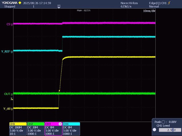

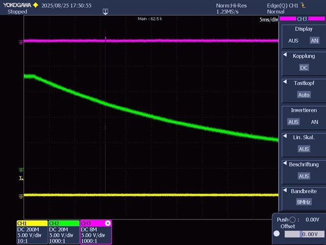

  • Hi Hong,
    I tried it with different ICs as suggested and It's the same behavior. No output pulses at the start and then a random output pulse during the turn off of the IC. Here are the waveforms during turn ON and turn OFF of the ICs.
    Waveforms during Turn ON
    Waveforms During Turn OFF

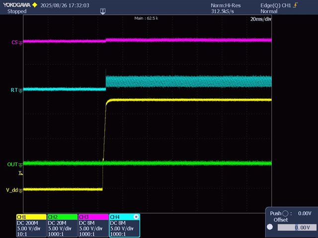

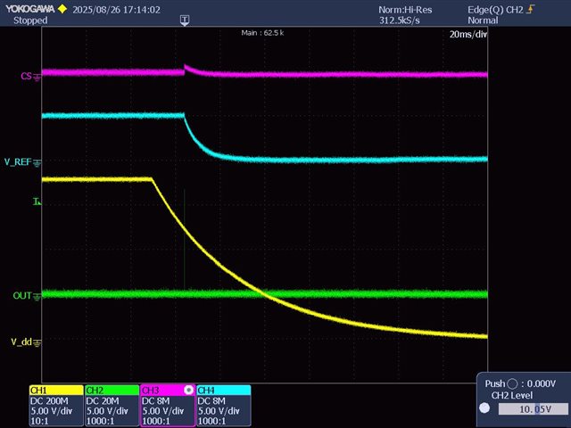

    Please provide VDD, RT/CT, CS and OUT pin waveform when VDD = 18V.
  • Hi Hong,
    Here are the waveforms during turn On and off.

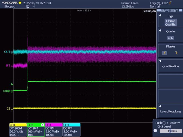

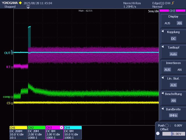

  • Hi Hong,
    I removed the R11, Q1 and Q2 components as suggested and was finally able to get some output waveforms. Here are the images:
    Waveforms during turn ON
    a close-up view
    Waveforms during Turn Off
    COMP pin voltage needs to be high enough to make OUT pin pulses show. Typically COMP pin voltage needs 1.5V or higher.
    Your waveforms show something pulling COMP voltage low. You can open COMP pin to re-test. Then add back circuit one at time to see which pulling COMP low to prevent from producing pulses.

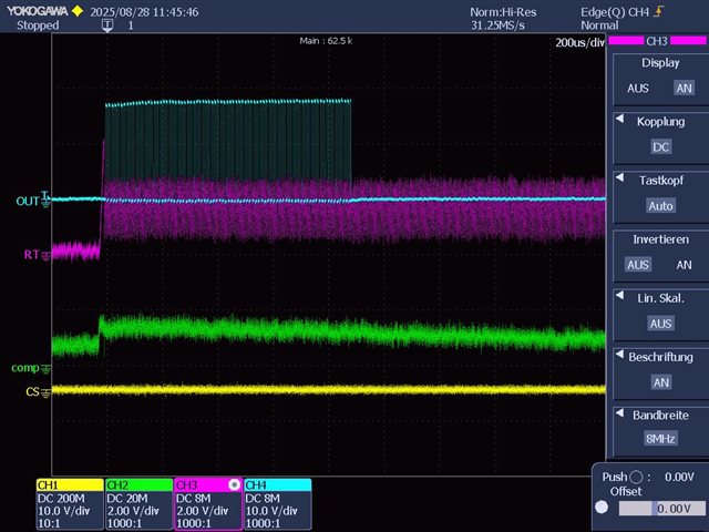

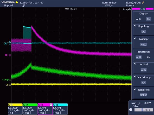

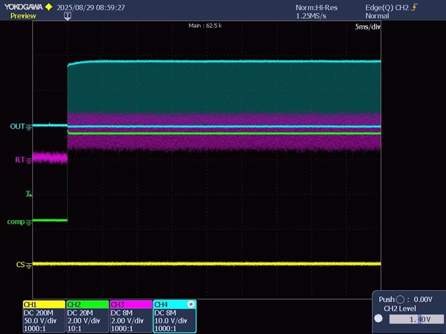

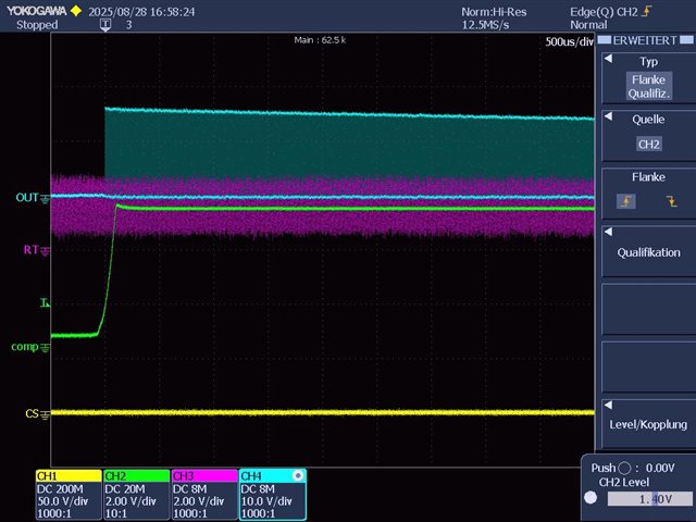

  • Hi Hong,
    I lifted the COMP pin of the IC and and even now it stays to low (around 300mV). Earlier it was giving some output at the start and the end but now, it just gives some waveforms on the output during turn off when COMP pin jumps to 5V for short time and nothing during turn on. Here are the waveforms of the behavior.
    Waveforms during turn on
    Waveforms during turn off
    You can short FB pin GND to try. If COMP still not rising then the ic is dead then you need to change to a new IC.
  • Hi Hong,
    When i short the FB pin to the GND, the COMP does rise to 5V and IC outputs the waveforms continuously. Does this mean i have a problem with my feedback loop?
    Yes you need to find why FB voltage is at that value which I guess > 2.5V to push down COMP < 1V then no pulses.
