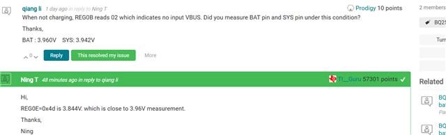

    When not charging, REG0B reads 02 which indicates no input VBUS. Did you measure BAT pin and SYS pin under this condition?
    Ning.
  • When not charging, REG0B reads 02 which indicates no input VBUS. Did you measure BAT pin and SYS pin under this condition?
    BAT : 3.960V    SYS: 3.942V
    REG0E=0x4d is 3.844V. which is close to 3.96V measurement.
    Ning
  • The difference is not significant, the battery voltage range is only 3.6-4.2v, and the total difference is only 0.7. 3.96v and3.844v the difference is already quite far, and the battery voltage I measured this time is not at the same batter level as last time. What's the point of comparison? Our problem now is not that the battery power measurement is inaccurate when discharging, but that when inserting the charger, the battery power cannot be accurately read. Your suggestion is not related to our question at all. Can you take a look at the question I mentioned earlier and answer it directly, so that we can provide data that is also related to the problem, rather than saying a bunch of irrelevant things? it's over. I still hope you can take this issue seriously, thank you!
