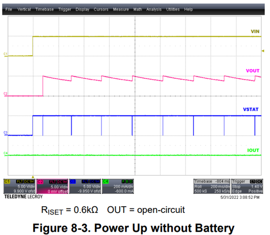

Hi Team,
In the absence of battery, the BQ25172 output voltage will rise to the input voltage.
When the LM66200 output load increases, the VUSB voltage will drop.
Become powered by BQ25172, Causes system shutdown.
Is there any way to improve this problem?
  • Hi Allen
    The BQ25172 in a no battery condition will increase output voltage to VOUT_OVP (1.7V/cell) then turn off.  OR it could be triggering SLEEP (Vin-VOUT) which is 0.135V.
    In both cases charge will stop.
    BUT the device does not have a battery detect feature.
    Can you send a schematic for review?

  • Hi Allen
    Thanks for the schematic, they look OK.
    We would need to disable the BQ25172 when the battery pack is removed.  Pulling the TS pin low will disable the device.
    When is the battery pack removed from unit?  Is this a configuration for some models of devices?
