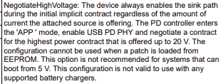

1. If they want to start up TPS25751 from NegotiateHighVoltage, can they load code from EC after the Vin3V3 is ready and send GAID to TPS25751?
2. If they don't want to code reset PD in NegotiateHighVoltage startup, is there any method to set up PD? Write register directly or?
    For negotiate high voltage, the PD will come up into APP mode even without VIN3V3 present. What we can do with an external EC is once VIN3V3 is present, they can issue the GAID command to reset the PD controller and put it back into PTCH mode. After that the system can then send the patch over I2C. Let me confirm with the team if there are any issues in supporting this and that there is no case where we cannot put the PD into patch mode.

  • Hi Kevin,
     Thanks for your response.
    About GAID reset funciton, it need few seconds to reboot system. I just want to know if there's any method to speed up the reboot process.

  • Hi Gary,
    Of course!
    There is no way to speed up the update process and do it in another way outside what is described in the I2C programming guide.
