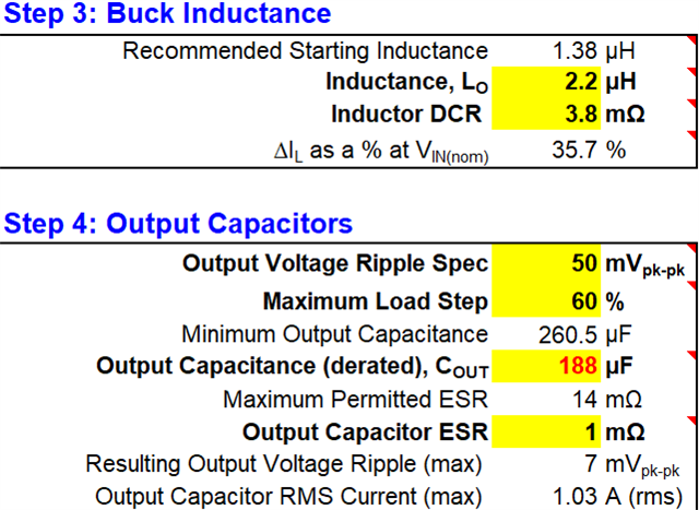

Hi all,

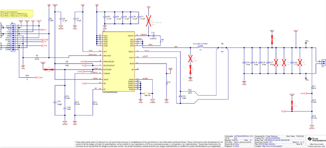

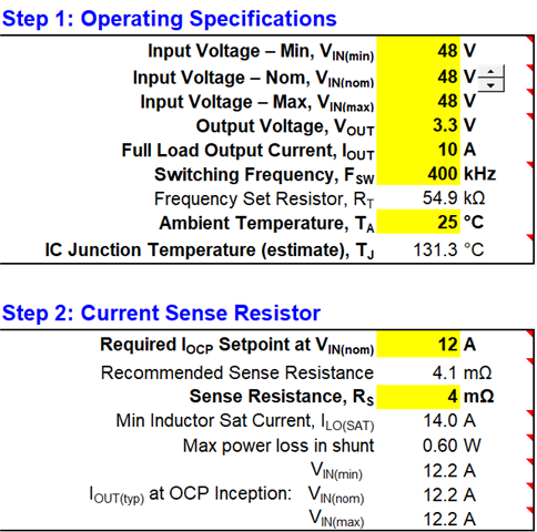

I use LM706A0 EVM board to test 48Vin/3.3Vout@max 10A condition and see the transient regulation out of 5%.

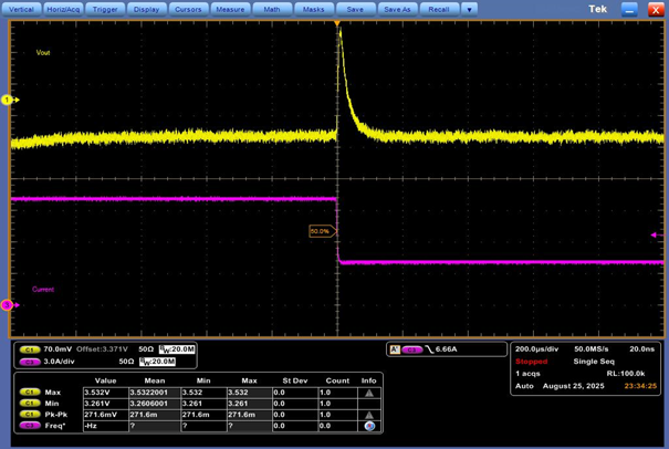

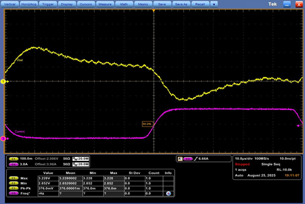

Transient condition is 4A to 10A with 2.5A/us, using differential probe to measure Vout.
Fs: 300Hz , Max Vout : 3.532V (deviation 6.08%), Spec:3.496V
Fs: 10KHz , Min Vout : 2.852V (deviation 14%), Spec:3.163V

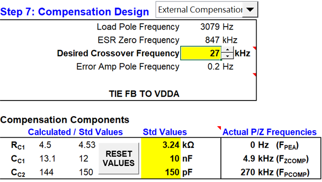

Should I modify compensation circuit?
Currently Rcomp is 3.24K, Ccomp is 10nF, CHF is 150pF.
Thanks.
