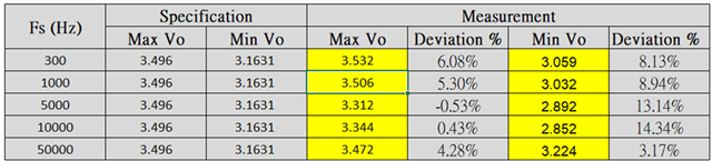

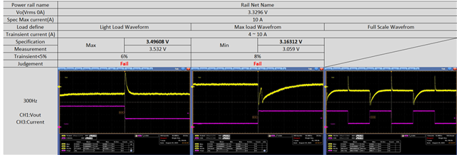

Hi Team
could you suggest how to reduce load transient to +- 5% level?
below is customer side result
they also find double pulse when heavy load.

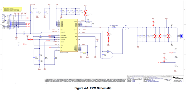

Hi Ben C
All test was implement on EVM
So every setting just follow EVM default RC value. just need to refer EVM SCH

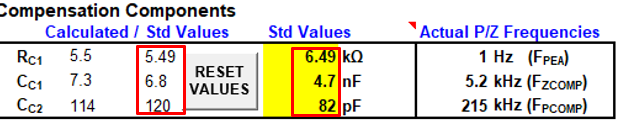

Hi Brian,
The compensation network needs to modification to increase the bandwidth of the loop. See attached quickstart calculator for the new compensation network BOM.
LM706A0_quickstart_calculator_A1_EVM.xlsm
Ben

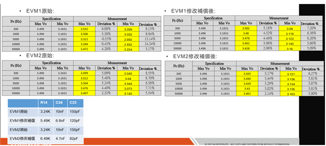

Hi Ben
follow the calculator result.
we find the transient behavior improve.
left part : before compensation right part: after compensation
but do we have any chance to get lower transient <5% under 4-10A transient of 3.3V output?

Hello Brian,
Looks like you are close to meeting specification.
Two options.
1. increase output capacitance and recompensate.
2. increase BW further, try: RCOMP=10k, CCOMP=10nF and CHF= 10pF. you may be able to reduce Rcomp a little and tune to just meet spec...
