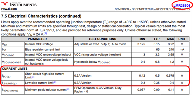

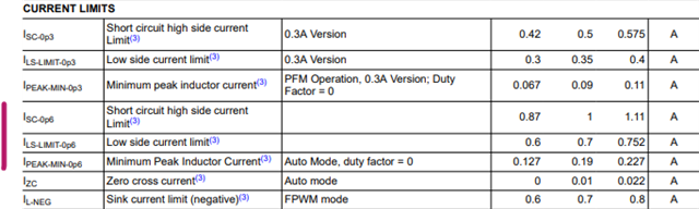

LMR36506: Current limit value of 0.6A ver
Part Number: LMR36506
Other Parts Discussed in Thread: LMR36503,
Hello team,
The current limit of LMR36506 (0.6A) is same as LMR36503 (0.3A). Why does LMR36506 DS shows the current limit for 0.3A? What is actual current limit values of 0.6A ver?
Best regards
Koyo
