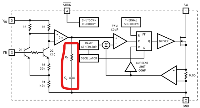

Hi All,
I have a question about the TLV61047 and LMR64010.
Do these two products have built-in phase compensation circuits?
The datasheet mentions "internal compensation," but I'm not sure if that refers to phase compensation.
Ishiwata
  • Hi Ishiwata,
    The internal compensation means the device has internal compensation for most cases to ensure enough gain and phase margin.
    Like the Rc and Cc in LMR64010's block diagram.
    In all, the internal compensation contains gain and phase compensation.
