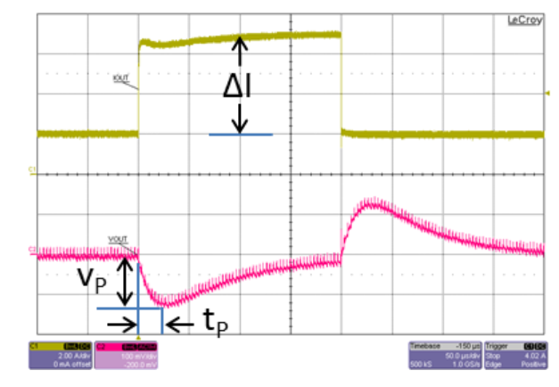

Could you share how much response time is until PWM mode starting from heavy load applied at light load PFM operation? Image is shown below.

  • Hi Youhao,
    Thank you for feedback. We are care about voltage dip by heavy load step transient in PFM mode. Could we estimate how much bandwidth is in PFM mode by using external component calculation? We want to know "tp" in below figure.
    https://www.ti.com/lit/ta/ssztal4/ssztal4.pdf
    Ochi

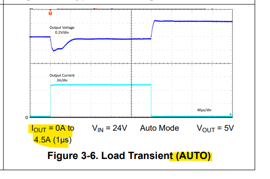

  • Hi Ochi-san,
    Depending on the starting load level in PWM, the bandwidth can be different. Instead, please ask the customer to refer to the LM65645 EVM user's guide.  Figure 3-6 shows the output response to the max step load, 0A to 4.5A in auto mode, namely in deep PFM (No load) to full load.  All other step load should result in smaller undershoot.
    The customer can also simulate this in Pspice.
