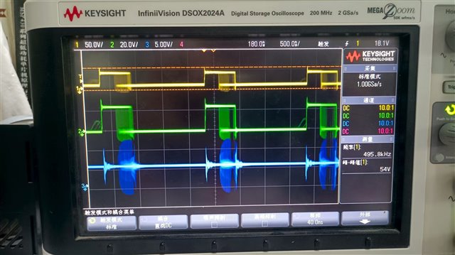

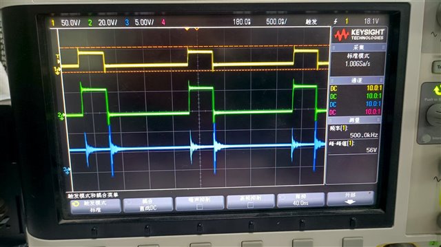

  • Here my load is not 700mA and 1A, my load is 5V/3A. It cannot start normally, which is due to the 800mA current at the input (Vin) preventing normal startup. Both 12V/800mA and 24V/800mA inputs cannot start normally. It is just that the input end requires a higher startup pulse current, but the source end limits the current to 800mA, which prevents the DC/DC from starting.
  • This is 24V Input setting 800mA current limiting,The DC/DC converter is not working properly. Probe 1 is BOOT,Probe 2 is PH(SW),Probe 3 is OUTPUT (5V)
  • This is 24V Input setting 1A current limiting,The DC/DC converter is  working properly. Probe 1 is BOOT,Probe 2 is PH(SW),Probe 3 is OUTPUT (5V),Normal work actual input 360mA/24V.
  • Hello Zhou
    As you correctly identified, the issue is likely your power supply’s 800mA current limit. Buck converters can demand higher initial current during startup to charge the output capacitor and supply load component
    Let’s calculate the expected input current:
    • Output Power (Po): 5V * 3A = 15W
    • Efficiency (η): Let’s assume 80% (0.8)
    • Input Power (Pin): Po / η = 15W / 0.8 = 18.75W
    • Input Voltage (Vin): Assuming 12V
    • Input Current (Iin): Pin / Vin = 18.75W / 12V = 1.5625A
    Therefore, the issue is likely a limitation of your power supply, rather than a device issue. Your power supply must provide current higher than required, especially during startup.
