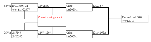

Hi Team,
There are two power supply modules with different power,
30W and 50W respectively, Supply 80W equipment.
How to design current sharing circuit?
The functional block diagram is as follows.
