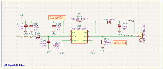

TPS61165: Schematic Review
Part Number: TPS61165
Hello there....
I am currently designing a backlight driver using the TPS61165, and I would like some help to verify if my schematic is correct. Could someone please assist me with this review?
I am also using a low-pass filter on Pin 5 to ensure the correct waveform on the PWM input.
Thank you in advance for your support.
