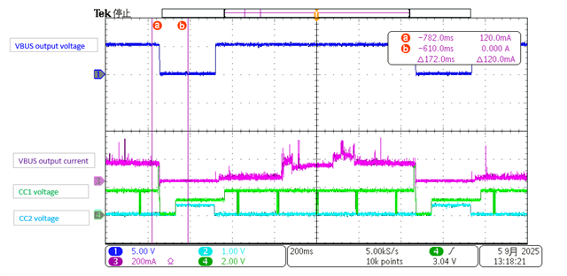

Hi all,
The following behavior can be seen when connecting a tablet PC of a specific manufacturer whose battery has been discharged.
VBUS output stops repeatedly
->Complete stop after a while
->The tablet PC cannot be charged
When my customer checked the signal,
they found that after CC1 terminal exchanges commands about 5 times, the CC1 voltage rises, and then the VBUS output stops.
Could you tell me what causes this behavior?

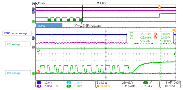

    There could be a number of reasons for the behavior.
    (1) VBUS drops because of the inrush of the dead battery condition.
    (2) Source is only sending source capabilities message 5 times and then stops sending.  If the PD on the PC is still 'booting', ie because of dead battery PD configuration was never loaded the PD will issue a reset because of sink timer timeout.
    (3) The system is not designed to support dead battery.
    You may want to confirm that the issue is not related to the source by attempting with different kinds of sources.

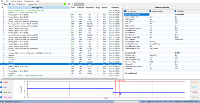

  • Hi Chris,
    I send the waveforms below.
    As CC1 has sent the command about 5 times, I am aware that (2) mentioned is most likely the cause.
    Could you please check the waveform and give me your opinion?
    If you have a waveform when the battery is not connected, I would appreciate it if you could share it with me.
    Ryusuke
    The waveform does not provide any information about the state of the PD controller in question. I am not clear if you are debugging the tablet PC or the source.  Can you confirm?  Which device do you believe is operating badly?
    The waveform below is with the logic analyzer tool.  This is with the Power DUO EVM.  Please note that the source is sending source capabilities multiple times.
    Chris
  • Hi Chris,
    Thank you for your reply.
    My customer used avhzy CT-3 to get PD command.
    From this communication log, I understand that there is no response from Sink and negotiation is not done correctly.
    1) Is it correct? I would appreciate it if you could give me any comments.
    Yes.  This is correct.
