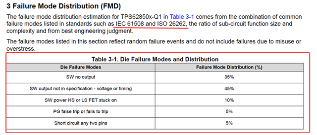

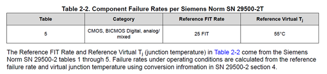

Hi team,
My customer have some questions about the TPS628502-Q1 FMEDA calculation.
The standard they are using is SN29500, and refer to our document, the FIT is 25.
But the FMD we provide are listed in IEC 61508 and ISO 26262, they asked we don't list the FMD in the SN29500?
So can you please provide some guides for the FMEDA calculation when they refer to SN29500?
