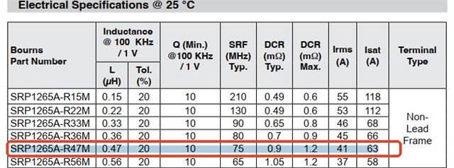

Our Inductance is SRP1265A-R47M , SRF is 75MHz

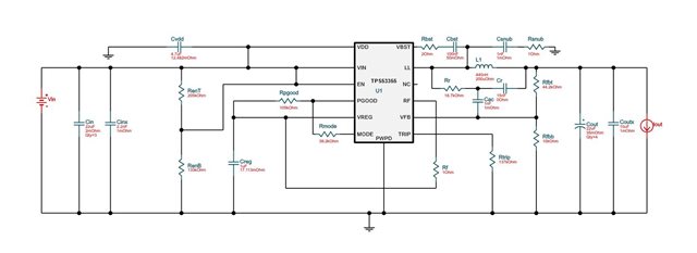

  • Hi Calan,
                We used WEBENCH build SCH is below
    Our SCH is below
    1.Our Trip Resistor is 150kΩ,I saw recommended design Trip Resistor is 137kΩ, Calculations show that the current limiting we set is greater than that of the reference design.
    2.We try all mode and all Switching frequency,When we set Switching frequency is 250kHz,the current limit is up to 18A,but other Switching frequency even 300kHz,the current limit just 4A.
    3.Our Inductor Parameter is below,we found that Inductor is OK
    4.Our input is from a regulated power supply, and we set the output of the regulated power supply to 12V/10A, which can output a total of 120W.
    5.The key parameters are copied from the reference design.And  Trip Resistor is larger that recommended design,Inductor we can not found 440nH,we found 470nH to replace it.And Rr we don have 18.7k ,we used 15k to repalce it, and we also try to repalce it with 18k,but the phenomenon is the same as before.

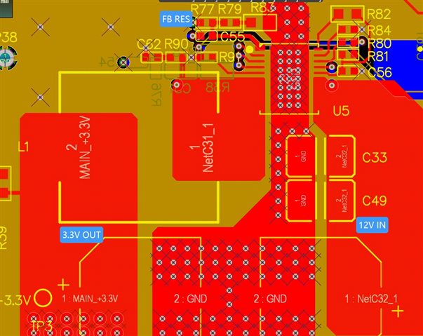

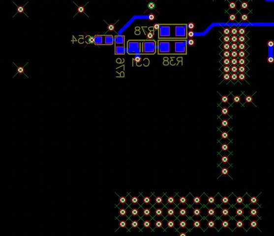

  • Hi Calan,
              Our PCB is 6 Layers,other layer is GND
    TOP
    BOTTOM is some FB resistor and Loop adjustment component

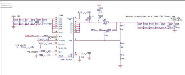

    I was able to review your schematic. I noticed some minor adjustments that can be made.
    • To confirm, you are selecting 970kHz as you are tying 0ohm to Vreg for RF. Please ensure this is desired
    • Inductor should be ok
    • Rtrip should be ok as well. It is recommended to use 107kohm, but 150kohm should not be an issue
    • I noticed your FB resistors equal 3.463Vout. You can modify these to 10kohm on bottom and 47kohm on top
    • I noticed you do not have a 4.7uF capacitor on VDD. This is highly recommended. Please add a 4.7uF capacitor on VDD, and let me know the result
    I am adding the excel design calculator which I have briefly inputted your design. Please refer to this and make any needed adjustments. Please also refer to the next couple of tabs which have schematic and layout checklist. Main issue I noticed is VDD not having 4.7uF cap.
    TPS53355 12vin 3_3vout 20A.xlsx
    Please let me know result.
    Thank you,
    Calan
  • Hi Calan,
    1.Yes,We had try 0Ω or 1Ω RF resistor to set 970kHz,we tested Switching frequency is 970.87kHz,it's OK
    2.Yes,we produced 10 boards and all board phenomenon is the same. Our inductors are samples provided by the manufacturer.
    3.Yes,we also try different TRIP resistor,we set TRIP resistor to 300k and 510k,but the current limit is the same,it just 4A.
    4.We set 10kohm on bottom and 47kohm on top,we tested Voltage is 3.42V,but the current limit is the same,it just 4A.
    5.We placed a 10uF capacitor on VDD,see Our SCH C914,it's for VDD.And we also change to 4.7uF,but it can not work,the current limit is the same,it just 4A.
