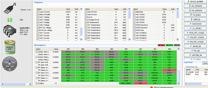

We are using BQ40Z50-r1 IC in our 4S1P battery pack design.
We are soldering the battery to board from negative point to most positive point. during that time the SUV,PF and CUV all bits are triggering and prevent the battery from charging.
After giving PF clear in bqstudio  it is able to charge and no fault occurs .Why it is triggering?
Whether this because i have enabled the Protection configuration and Enabled Protection A,B ,So sudden Spikes cause the failure. Kindly help us out to solve the problem.
