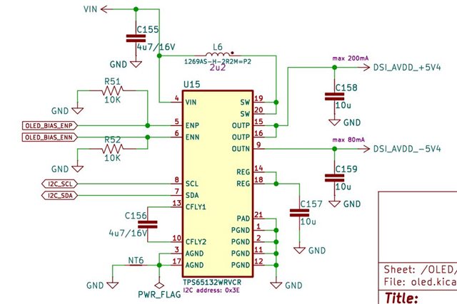

We are using TPS65132W in the 80mA mode.
But, 80mA is on the edge for our application, and we'd like to design a bit of a reserve.
  • Any recommendations / insights on how to go about it?
Our first thought is to simply beef up the capacitors around it: C155, C156, C157, C158, C159, such as by doubling them.
We have also tried using the "S" part, but found it difficult to route. Moreover, it is not clear how a smaller BGA can provide more current than a part that comes with a PowerPAD.
It would greatly help us to understand how the "S" variant goes about its stated high power ability, and whether we can apply some of its recipe to the "W" that we already have on the board, and are reluctant to change. The "S" SYNC input seems to be critical to that. We have FPGA connected to both ENP and ENN inputs and, if needed, can apply complex pattern on them.

  • The display in question is dual 0.49" FHD micro-OLED.
    BTW, while looking around, we ran into a similar discussion: e2e.ti.com/.../tps65132-tps65132wrvcr-output-voltage-drop. The option of changing the inductor from 2.2uH to 4.7uH is touched upon there, as well as checking inductor saturation current. Our inductor is 1269AS-H-2R2M=P2, which saturates at 2.2A.
    We are not concerned about VPOS output, as it comes with 200mA output capacity. Our typical VNEG load is 2 x 30mA. But, the OLED vendor says that the max into their display can be as much as 2 x 100mA. They did not explain how such wide variations are possible. We are also pushing on them to learn about the duration of that high loading condition, and whether it can qualify as a transient glitch.

  • Our layout designer reported difficulties routing the "S" part BGA. As the project schedule was under fire at that time, and solely in the interest of saving time, we've switched to the "W" part. We must admit that the "W" also looked more robust thanks to its large "PowerPad".
    While we are now looking to switch back to the "S" part in the next board spin, until it comes, we wonder if there is anything we can do within the constraints of the existing PCB to boost the VNEG/AVEE capability beyond 80mA?
    - We have I2C access and can adjust all register settings, possibly raising the OCP limit.
    - We can use larger capacitors around the TI part
    - We can increase the inductor from 2.2uH to 4.7uH if you believe that would help
    This is to solicit your commentary on these stopgap measures, as well as additional thoughts on enabling higher AVEE currents in the existing PCB framework.

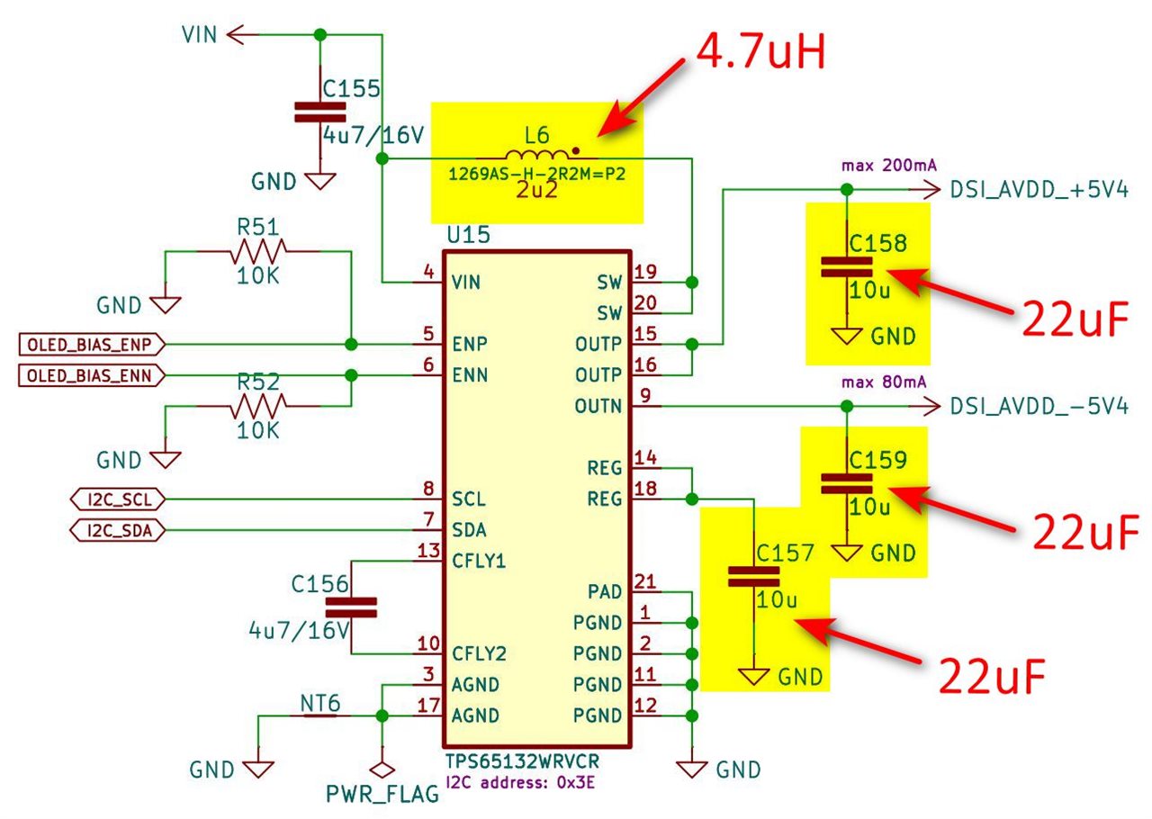

  • Given our objective to improve the situation within framework of the existing PCB, can we summarize your recommendation as follows:
    - increase C157, C158, C159 from its current 10uF to 22uF
    - increase L6 from its current 2.2uH to 4.7uH
    Please confirm. Could you please also quantify the expected effect of this upgrade.
    - Would it be possible to solidify this answer by providing the results of before and after simulations?!

    Adding L and cap will reduce ripple and increase stability. It is no use to enlarge the IC long term output current capability.
    But 200mA short-term surge is feasible as long as you increase the output cap. I think 22uF is enough but it is better to keep one more cap position which is unsoldered.
    Colin
  • Are you thinking of a 10uF for that unsoldered backup position? Or another 22uF?
  • Yes, another 22uF is good.
