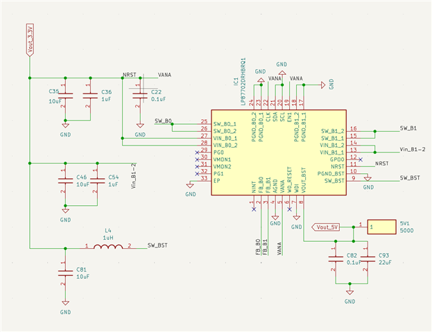

Dear Team,
I have designed a schematic for the LP87702-Q1 buck converter. I plan to test it in standalone operation without any digital input/ouput other than a 3.3V Vin.
My target outputs are:
  • 1.8V from SW_B0
  • 1.24V from SW_B1
  • 5V from VOUT_BST
I have followed the schematic checklist (https://www.ti.com/lit/zip/snvr494).
For the pin configuration:
  • CLK, SDA, SCL, EN1 are tied to GND
  • GPO0, PG0, PG1, VMON1, VMON2 are left unconnected
For this design, and the schematics are attached below for your reference.
Could you please confirm if there is anything I might have missed?
Also, can this schematic operate under the conditions described above?
Thank you in advance for your support.
