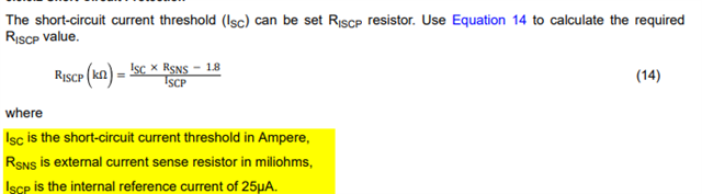

  • Hi Toshi-san,
    For # 1. Isc is whatever current threshold you want to set for short circuit protection. 100A for example can be used in Eq 14 to calculate the needed RISCP value.
    The maximum guaranteed time before the short circuit is recognized is 5us in active mode and 4.5us in LPM. It could be faster, but no slower.

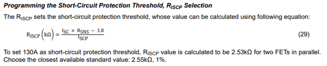

  • Hi Toshi-san,
    These values are not constant. They are chosen based on customer needs. If a system needs to shut off at 130A then you use this value to select the correct RISCP to set this threshold. You must have an idea of the desired short circuit protection threshold in order to select RISCP....
    See below as a design example:
    Sarah
