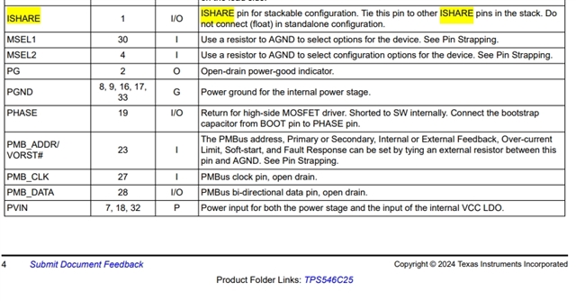

Dear TI Forum,
the datasheets explicitly says "to not leave the pins floating in standalone configuration". But should it be tied to GND, VCC, PMBus Voltage ?
Thank you.

I used control-f to search the datasheet and I do not find the text "to not leave the pins floating in standalone configuration" in the datasheet.
However, I did find the following in the pin descriptions (images below) on page 4 and 5.
In standalone configuration, both pins should be floated and not connected and the schematic in Figure 8-1 following the recommendation.
David
No worries, thanks for posting. We are currently updating the datasheet to resolve other typos.
