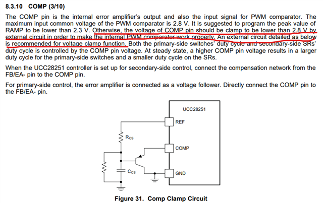

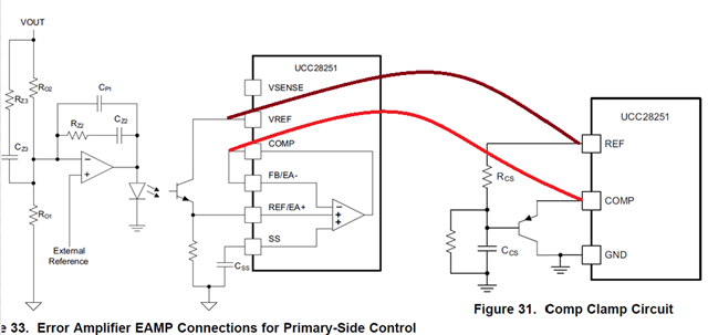

The datasheet provides 2 different diagrams for COMP pin connection.
We are using this IC for Full bridge application, Primary control and peak current mode.
Should i combine both of the below circuit for COMP pin.
first is for Primary control, second is for voltage clamp above 2.8V.
