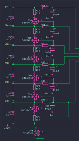

I'm using a BQ40Z80 with external balancing on a 6S, 5AH pack.  Balancing circuit is as follows in the image below (note, the 51R resistors have now been replaced with 18R to try to increase balancing rate)

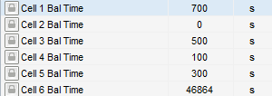

I have noticed that cell balancing does not always occur, even when a large imbalance exists.  To test this, I charged a single cell (cell 6) in the 6S pack slightly more than other cells.  The BMS reflects this in the calculated balance time:
