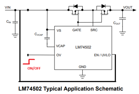

LM74502: Minimizing Delay Between VEN Activation and Gate Voltage Rise
Part Number: LM74502
We are using the LM74502QDDFRQ1 IC to drive two back-to-back connected NMOSFETs (NVMFS5C673NLAFT1G), which have a input capacitance (CISS) of 880 pF. We have selected a VCAP capacitor of 10 nF, and the input supply voltage is 14 V.

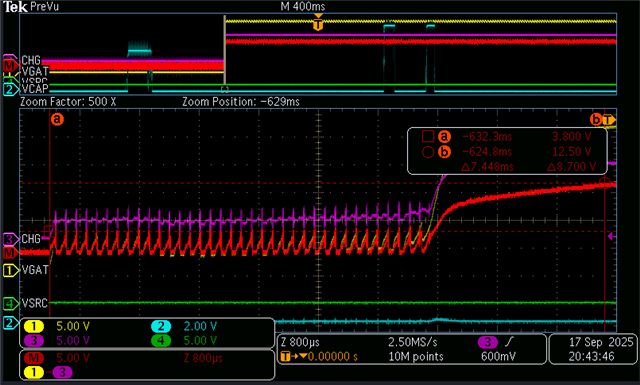

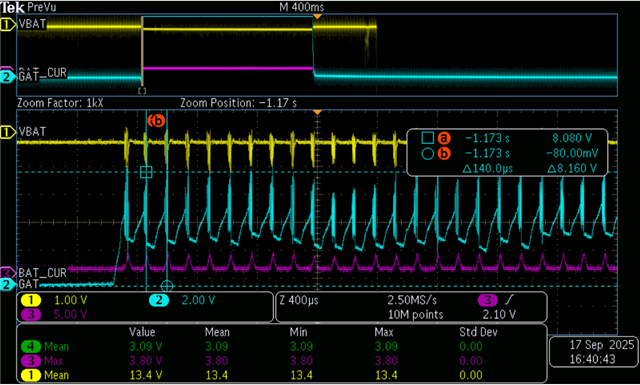

However, we’ve observed that the IC takes approximately 1 ms for the VEN signal to gate rise. Could you please help us understand how we can reduce this rise time?
