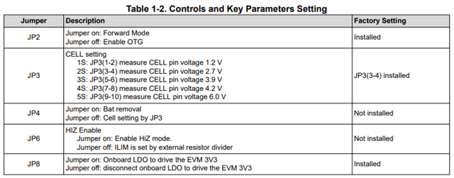

The parameters settings of the BQ25731EVM are as defined inside the datasheet, except for CELL setting placed on JP3(1-2).

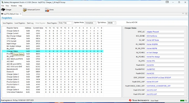

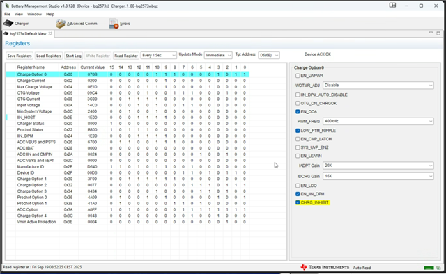

Charge disabled:
Charge enabled:
