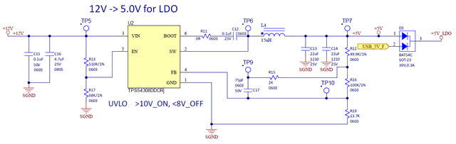

Hi
Please help review schematics, thanks!
Hi Kevin,
What is your load current?
Rupayan
30V~56V (TYP 48V) , LOAD <1A
Just change R12 resistor to 49.9ohms.
