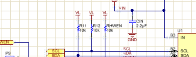

Customer is testing TPS65132S in their system.

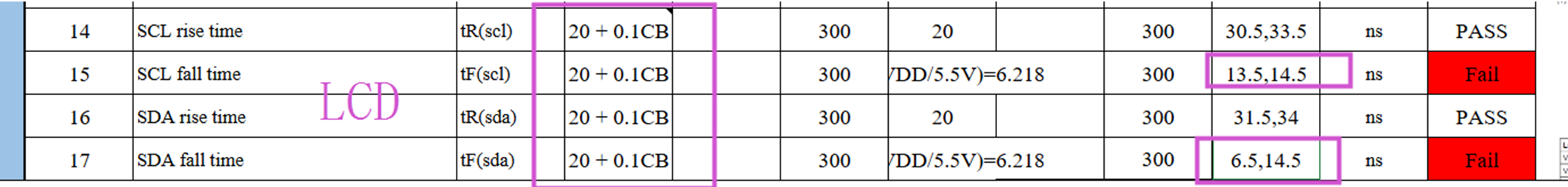

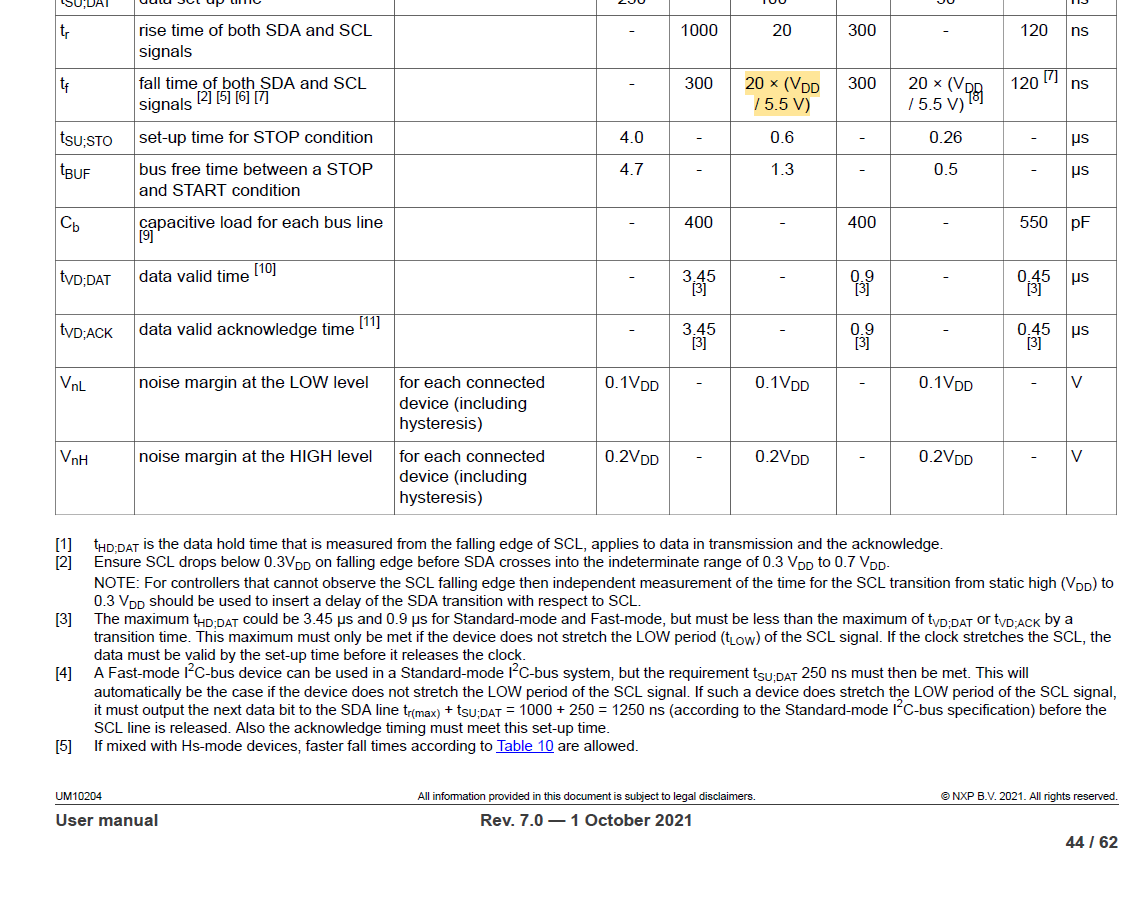

They find the SOC output fall time timing is faster that spec, while it match I2C public spec.
Now, communication is OK, could you help check if this is OK for TPS65132S?
