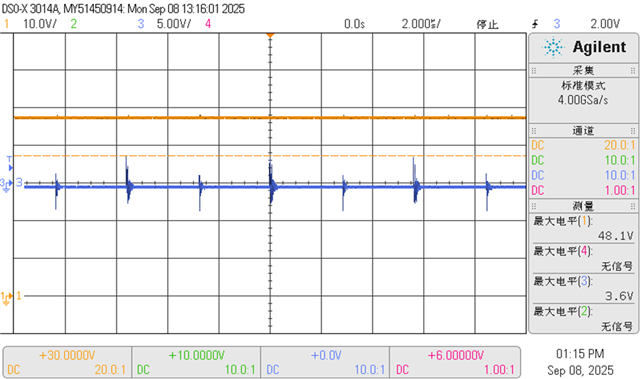

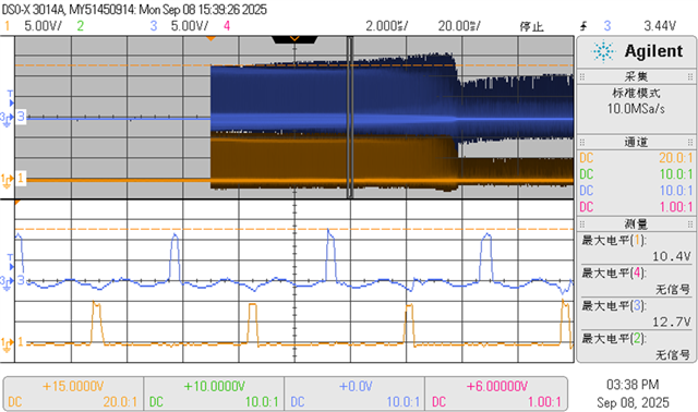

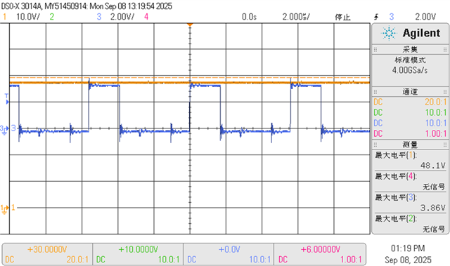

  • Hi Jonathan
    Thank you for your replied.
    This is the waveform comparison between the faulty module and the normal module.
    This is the process of turning on the computer after I became paranoid.
    You can see that at the beginning PWM outputs according to the duty set by the bias, and then gradually changes to the minimum duty.
    Ezra
  • Hello Ezra,
    The third waveform looks like something is wrong in the hardware. The waveform looks noisy and shaky, which indicates a weak signal. You have confirmed that the customer's hardware is correct and it is only the UCD that is causing the issue? How often do these faults occur?

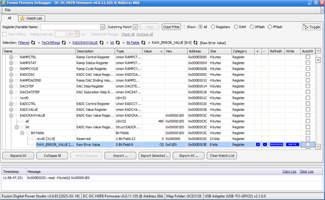

    One thing you can do is make sure that the UCD3138 is receiving the right input information. You can use the Fusion GUI's memory debugger to find values such as "EADCRAWVALUE". Compare the bad UCD3138 reading vs. the good UCD3138 reading. An example of how to read the value is shown below.

    II cannot get the stored information by reading the register. In our mass production mode, we have commented out the register reading function.
