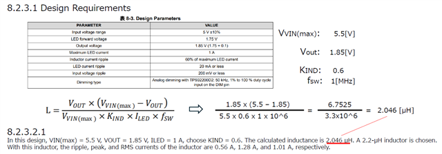

Hello experts,
I am considering the use of TPS92200D2.
I would like to drive two LEDs in series with a Vf:6.6V at approximately 90mA, as shown in the attached schematic. Could you please provide the recommended values for L and C?
Also, is the calculated value for the current sensing resistor (R) for the FB acceptable?
Schematic diagram of TPS92200D2
