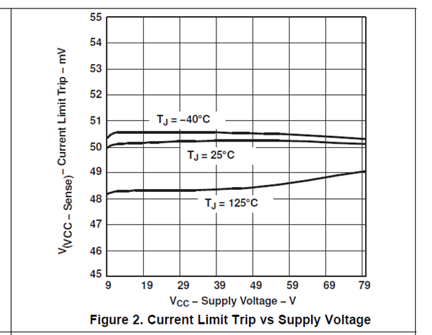

TPS2491: VCL (Current sense threshold V with power limiting trip) temperature chractics
Part Number: TPS2491
Dear E2E support menber.
About TPS2491DGSR.
We can confirm the temperature characteristics of VSENSE (50mV typ) from the graph shown below.
Please provide similar graphs for VCL (25mV typ) and VREF (4V typ).
We would like to confirm the temperature characteristics at the power limit.
Best regards.
