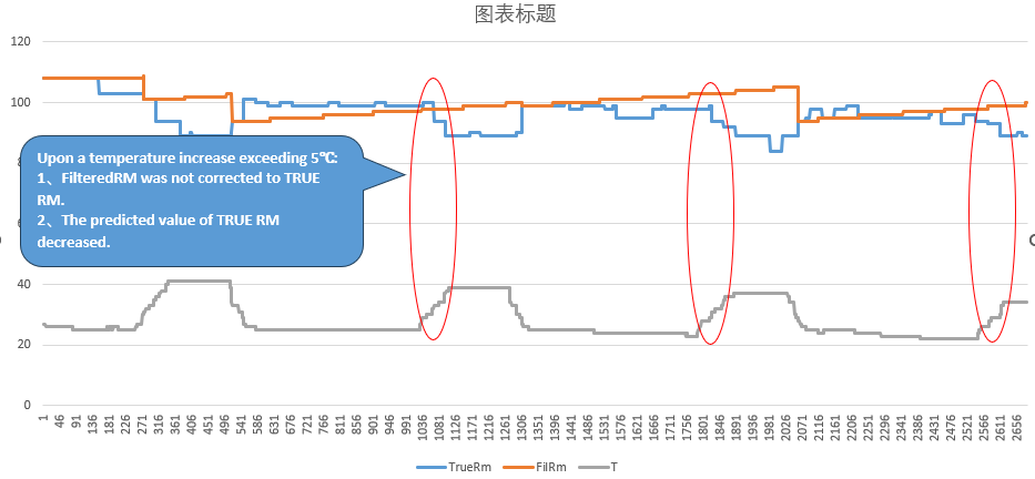

    我们在测试过程中,
    发现温度上升超过5℃,TRUE RM下降;温度下降超过5℃,TRUE RM上升。
    1、这属于正常现象吗?为什么?
    2、另外在附件的sheet[test2]中,还出现了温度变化超过5℃,但Filtered RM未修正为TRUE RM的情况?为什么?
    During our testing, we found that TRUE RM decreases when the temperature increases by more than 5℃, and TRUE RM increases when the temperature decreases by more than 5℃.
    1、Is this a normal phenomenon? If so, why?
    2、Additionally, in the attached sheet [test2], a situation occurred where the temperature changed by more than 5℃, but the Filtered RM was not corrected to TRUE RM. Why is that?
    Test of TRUE RM Change with Temperature Variation.zip
  • #1: It looks like this chemistry significantly adjusts DOD0 at high grid points, which impacts True RM in the way that you observe.
    The gauge models cell behavior with OCV(DOD, T) and R(DOD, T). R usually decreases with temperature rising. Therefore, if you see True RM falling with a rise in temperature, like in this case, it's not due to R but as we can see here, it's due to DOD(OCV, T).
    #2: The gauge will override the auto-sync if the trigger for a simulation was time (every one hour in relax by default).

  • #1 depends on DOD and how the gauge models OCV for a given DOD. The previous example modeled higher DOD for rising temperature, hence True RM dropped. Therefore the effect changes with DOD and with ChemID.
    #2: There are many details of the algorithm that are not documented. I studied the firmware to answer your question so the source of my answer is in the actual source code. It has a time threshold (default 1 hour), which will override the temperature triggered simulation and because of this override, it also overrides the RCJumpOk sync of filtered and true values for this particular simulation trigger.

    #2: This isn't related to the age of the cell but to the supply voltage of the gauge.
  • HI Dominik,
    我们电池的使用温度是10℃--75℃。能提供RM自增间隔最短的场景吗?
    The operating temperature range for our battery is 10℃to 75℃. Could you provide the scenario where the shortest RM self-increase interval occurs?
  • Most likely at 10deg.C
  • Hi Dominik,
    我们实测的结果是高温+新电池场景是最短的RM自增间隔。常温+老化电池场景是最长的RM自增间隔。
    1、这属于正常现象吗?
    2、RM自增的间隔在不同温度环境下是线性的吗?
    Our measured results show that the shortest RM self-increment interval occurs in the high-temperature + new battery scenario.
    The longest RM self-increment interval occurs in the normal-temperature + aged battery scenario.
    1、Is this considered normal behavior?
    2、Is the RM self-increment interval linear across different temperature environments?
  • The coulomb counter noise, which is the root cause for the increase over a long period of time should be less at lower temperatures. As the accumulation over a long amount of time is a known behavior and TI addressed this with the SMOOTH_SYNC command, it's considered part of the gauge's behavior.
    I don't know if it's linear over temperature.
  • HI Dominik,
    能否通过实测或理论分析,给出RM最短自增间隔的极限条件?我们需要根据这个条件,来分析对市场产品的影响。
    Could you please provide the extreme conditions for the minimum increment interval of RM through actual measurement or theoretical analysis?
    We need to analyze the impact on market products based on these conditions.
  • HI Dominik,
    结合我们的应用,罗列了RM最短自增间隔的测试项,请帮忙确认:我们罗列的测试项是否可以测出RM最短自增间隔时间?还需要哪些FuelgaugeIC的参数?
    应用温度: Min 10℃,Max 74℃
    SOH:电池寿命终结=65%
    RM值:
    694mAh--->电池最大充电容量;
    632mAh--->电池容量,低于632mAh时,启动充电到694mAh;
    98mAh--->电池放电时,停止放电的容量
    We have listed the test items for determining the shortest RM self-increment interval based on our application. Could you please help us confirm the following:
    1、Can the listed test items effectively measure the shortest RM self-increment time?
    2、What additional Fuel Gauge IC parameters are required?
    Application Parameters:
    • Battery Temperature Range: Min 10℃, Max 74℃
    • SOH Threshold: Battery End of Life (EoL) = 65%
    • RM (Remaining Capacity) Values:
      • 694mAh to Maximum Charge Capacity (Full Charge Capacity when new)
      • 632mAh to Battery Capacity threshold; charging starts when the capacity drops below 632mAh (and charges back up to 694mAh).
      • 98mAh to Capacity at which discharging stops.
    Best regards!
  • I don't understand the request. I don't have data about the shortest RM self-increment time for different temperatures. The self-increment is an artifact of the smoothing algorithm and a part-part variation of offset error.
    The official recommendation is to either disable smoothing (the gauge will then self-correct automatically at every OCV measurement) or sending the SMOOTH_SYNC command after a long time in relax where filtered RM may increase by a few mAh.
  • Hi Dominik,
    感谢你的支持。
    没有相关的数据,我们了解了。
    现在我们想基于设备的使用场景,通过测试进行RM自增间隔的极限值确认。
    之前有说过温度对RM自增有影响,结合我们的实测结果,我们认为通过电压、温度、健康度这三个因素的矩阵测试,可以测试出极限值。
    请帮忙确认,是否正确?
    Thank you for your support.
    We understand that you do not have the relevant data.
    Now, we want to confirm the limit value for the RM self-increment interval through testing based on the device's usage scenarios.
    It was previously mentioned that temperature affects RM self-increment. Combined with our actual measurement results,
    we believe that a matrix test covering these three factors—"Voltage, Temperature, and SOH"—can determine the limit value.
    Could you please help confirm if this approach is correct?
  • Hello Zhangjin,
    Are you in a email thread with Dominik on this?
    -Miguel
  • HI Miguel,
    没有固定为Dominik,只是这个Thread之前一直是Dominik回复的。
    TI其它人员帮忙确认问题,也是可以的。
    It’s not limited to Dominik; it’s just that Dominik has been the one replying to this thread so far.
    It’s also fine if other team members from TI can help confirm the issue.
  • HI TI Team,
    We have not yet received a reply to the aforementioned questions. Could you please respond as soon as possible? Thank you!
  • I do not know if this approach is correct. TI doesn't have the bandwidth to support your deep analysis of this system. Please use the SMOOTH_SYNC command as recommended, which is the official solution from TI.
  • HI TI Team,
    Thank you for your detailed responses earlier!
    From our previous communication, we understand that RM self-increment is related to coulomb counter noise, which is influenced by temperature and voltage.
    We would like to further confirm:
    besides temperature and voltage, what other parameters does TI refer to when analyzing and verifying coulomb counter noise?
    #2: No, the rate depends on the noise of the coulomb counter. This is different between parts and also a function of environment (e.g. temperature and voltage).
    感谢此前的详细回复!
    根据之前沟通,已知 RM 自增与库仑计噪声相关,且库仑计噪声受温度、电压影响。
    想进一步确认:TI 在分析、验证库仑计噪声时,除了温度和电压,还参考了哪些参数?
  • The gauge uses an internal algorithm (a non-linear filter using various thresholds) to analyze and gate the noise. They are private parameters and not shared.
    This problem will have to be handled with SMOOTH_SYNC, which is a fully validated. There is no other TI-endorsed method.
  • HI Dominik,
    We understand that you cannot provide specific parameters as they involve TI’s patents.
    1、Regarding the noise mentioned in our previous communication being a function of the environment (temperature and voltage), can we understand that temperature and voltage are the main factors affecting the RM auto-increment interval? Are other factors negligible due to their small impact?
    2、Additionally, regarding the mentioned differences between parts, does "parts" refer to individual ICs or different batches of ICs? Are differences between parts a major factor?
    感谢支持。
    具体参数涉及到TI的专利无法回复,我们了解了。
    1、之前沟通的噪声是环境(温度、电压)函数,是不是可以理解为温度和电压是影响RM自增间隔时间的主要因素?其它因素占比很小,可以忽略?
    2、另外,提到的不同parts有差异,不同parts是指单个IC还是不同批次的IC?parts差异是主要因素吗?
  • I do not have more information about this topic. Please use the TI recommended method: Send SMOOTH_SYNC after a significant amount of time in realx.
