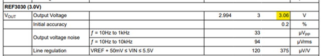

Hi team,
The customer find the typo in datasheet.
The max output voltage of REF3030 is not "3.06" but "3.006", right ?
They are also requesting to revise the datasheet correctly.
Morita
Hi Morita,
You are correct, there is an error in the datasheet that will need to be corrected. Thank you for letting us know, we will look into the issue.
