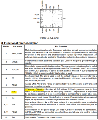

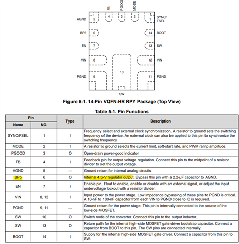

do we have any other buck have same spec with TPS543320 but LDO output is 3.3V?
Because RTQ2833A LDO is 3V output. we can fully B2B if we have 3V solution.
https://www.richtek.com/assets/product_file/RTQ2833A/DSQ2833A-00.pdf
