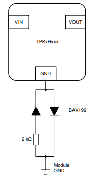

  • Hey Joe,
    It looks like you are looking for designing for loss of ground and loss of battery protection. There is an application note that outlines the protections implemented to protect the device in these conditions.
    https://www.ti.com/lit/an/slvaes9a/slvaes9a.pdf
    Loss of GND
    To protect against this double fault condition, appropriate design considerations have to be made to the resistor / diode network connected between the ground pin of the high-side switch and the local device ground. To protect against the described parasitic fault condition, it is recommended to increase the value of the resistor on the ground network to around 2 kΩ and to change the unidirectional diode to steering diode configuration such as the BAV199.
    Inductive Loading and Loss of Battery
    • Connecting a flyback diode in parallel with the load - In loss of battery potential on VS will be undefined.
    • Use of a resistor/diode network on GND pin and serial protection resistors
    The application note will have more information for this specific fault case. As for the + Load disconnect requirement this will be handled by the microcontroller based on the SNS pin output.

    As the module and load GND is common wouldn't just a flyback diode be needed to provide protection
    for the TPS4HC120 and microcontroller. ie. diode/resistor to GND and current limiting resistors to microcontroller are not required.
    Regards Joe
  • Hey Joe,
    This is correct. As the module and load GND is the same only a flyback diode will be needed to provide protection.
