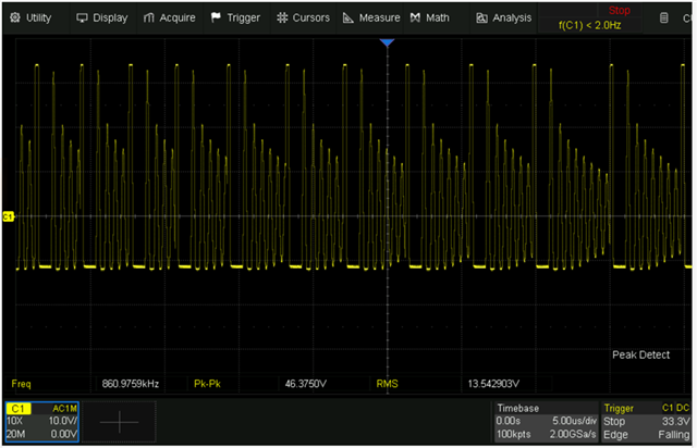

Hi!
I'm getting this waveform at the output of a LMR38010S converter, from 48 to 12V. Anyone knows what is happening?

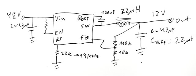

I followed the webbench design tips, I also checked with "classic" design equations and datasheet equations.
This kind of oscillation at the output doesn't change with:
   - Increased current (from 50mA to 500mA)
   - Changing output capacitance (nominal 22uF, try from 18 to 44uF, effective capacitance at 12V)
   - Inserting compensation capacitors in the feedback loop (10pF, 47pF, 100pF)
Output, (100uS/div)
Switching node (5uS/div)
This is the simplified schematic:
Does anybody know what can be wrong?
