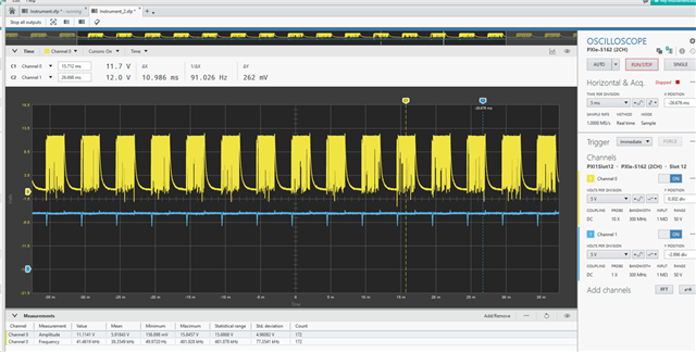

We are using TPS92200D1EVM, and below are our questions:
1) We see EVB is configured for 495mA current by having Rsense of 0.2 ohm. I currently have 20-ohm load and current is increasing linearly with input voltage of EVM instead of constant 495mA. Is this expected?
2) We have another constant current source connected in parallel to EVB output and the output current of constant current source is 100mA. With this configuration i expected 600mA at load (20 ohm), considering 500mA from EVB and 100mA from CCS. But the EVB output current itself if adjusted, i mean output current is reduced from EVB (400mA instead of 500mA), resulting in total current at load to 500mA.
Let me know for more details.
Kiran. A
