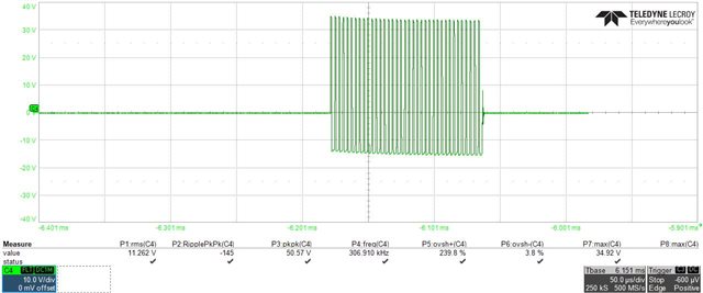

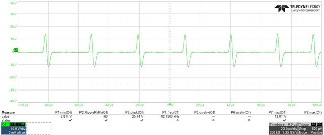

  • Hi Arpita,
    I've considered 20uF, 50V ceramic capacitor. Switching frequency is changing with the different capacitor not with the capacitance value.  I've measured switching frequency across the inductor and waveform has been attached for your reference
    Inductor voltage with output electrolytic capacitors (C71, C72)
    Inductor voltage with output ceramic capacitors (C71, C72)
  • Hi Spoorthi,
    Are you measuring voltage across inductor? Voltage between SW node with respect to Vout?
    To measure frequency, you need to probe SW node wrt GND [NOT across inductor}.Kindly share the same.
    regards
    Arpita
  • Hi Spoorthi,
    What is the load current at which you captured the above waveforms? Kindly note that in PFM mode during light load, the switching frequency reduces depending upon operating conditions and circuit parameters. Can you please measure at higher load current (CCM)?
    Arpita
