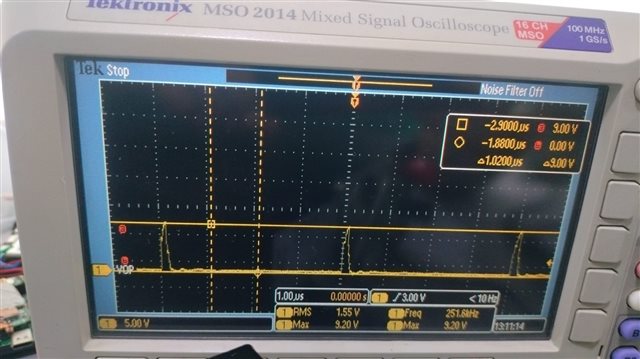

    I am trying to build the circuit on the GPB first but unable to get the output voltage which is only 1V.
    I have shorted the VBIAS=VCC=9V , UVLO=9V , Fsw =250KHz has been set.
    Please find the waveforms for Gate and Drain pin switching of Mosfet. Let me know what can be done further or what is wrong ?
    I haven't connected any load yet.
